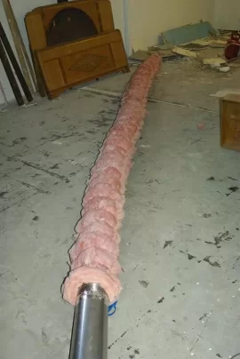

That would be better than the pink stuff. >>
[Hearth.com] liner question
wow thats funny bart and kind of sad
honestly i dont doubt that roxul would work fine but it has not been tested and there for is not approved for that application. And that fact will cause you problems if anything ever goes wrong.
