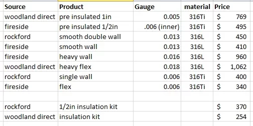

anyone have any thoughts on this list?
Looks like pre-insulated from fireside might be the best option
I really prefer heavy wall liners for wood but regular light wall will work ok. Avoid the doublewall smooth inner crap.

thanks for the advice. I would prefer straight pipe instead of flex but I'm not sure I can make it... Maybe with a piece of ovalized or a block off plate and a short section of flex. gonna take another look today.
What makes the double wall 'crap' compared to the single wall in your mind?
If it is 2ply smooth innerwall flexible liner it simply is not durable at all.
Ok but what liner you have listed is rigid pipe? The specs all look like flex to me.
I had an insulated flex previously.
the little pricing comparison I posted was for flex.
However I think I can get solid pipe down there... Looks like Woodland direct has .025" 304/316 stainless single wall for $432/$624 respectively. Thats a fair bit cheaper then the heavy wall flex.

Yes rigid is cheaper than heavywall but it is a pita to install with no real benifit. Actually with your voncern about excessive draft standard light wall will cause as much restriction as going down to 5.5 if the 5.5 is smooth

Yes i would always recomend insulation. We never install a liner without insulation. And yes the corregations offer a fair ammount of resistance about equal to downsizing by .5 inches. I dont use lightwall for wood stoves but it would offer you some extra resistance. I still dont understand why you have such excessive draft though.
