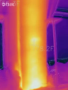

This is the interior lined chimney above the old Jotul 3 CB a few years ago. The Flir only shows it being 78 at that hot spot, so not super hot, but in the 66 degree room you could feel that. Cool to the touch with the Progress Hybrid, which puts the heat into the room and not the chimney. Haven't done the IR of that chimney with the Progress.

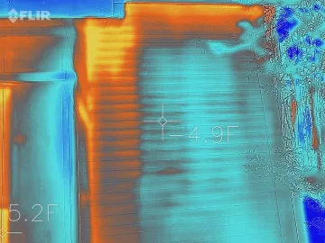

And from the exterior, Jotul. Chilly morning. Guess where the chimney is
