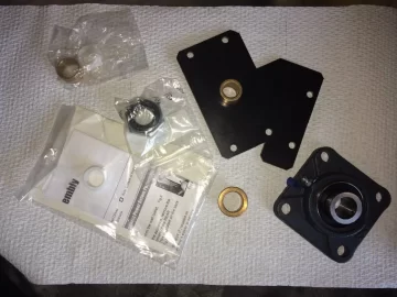

The EF-3, that I was working on is gone now. The new Gleason-Avery ball bearing auger motor and nylatron auger bearing I installed on the 3/4" auger shaft (pre-2008 stove) should make it last forever!
Do you still have your EF-2? Does it have the BIG 3/4" auger shaft?
Just doing a study
See pics of my collection
Standard 5/8" SAE 841 bronze oilite needs cleaning and lubrication
Nylon - permanent lubed 5/8" better than bronze
Nylatron - harder and permanent lube for use with a large 3/4" diameter heavy duty auger shaft - best combo for a top feeder!
