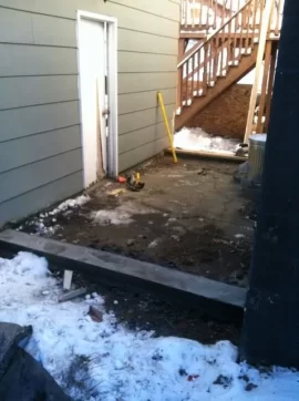

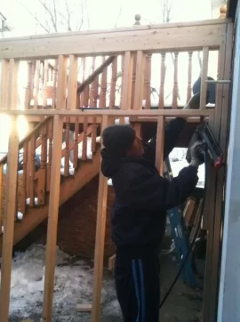

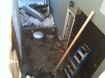

We've been wanting to build something to keep us dry between the house and garage. Snow tends to drift there and wanted to be able to walk into the house without getting rained on. So put ths up this past weekend!

Is there are real foundation under that? And more importantly, what the heck were you doing with the chainsaw on the roof?
Yes there was a real foundation poured for the build.
Chainsaw was to trim the truss that was a too long. Others saws wouldn't reach.

The existing pad that was there was cut out for the footers and dug down. Also tied into the the existing footers on both sides. It is hard to tell from the pics.
Yes I tried a circular saw and it cut down to about 2 inches off the plate. Couldn't finish the cut so grabbed the chain saw. Worked like a charm, and had to throw a pic in there. Got the roof on now, gotta wait on electrician now.

How did you flash the interface where the new roof meets the sidewalls of the garage and house?
I was going to ask the same thing. Swagler, did you put some flashing up behind the siding on both the garage and house? I can see where you cut the siding out to get at the sheathing, but didn't see any flashing agains the house when you shingled it......make sure you have flashing there or prepare to be miserably mad at the water problems you're gonna have....
Yeah it's flashed. Slid a piece of flashing under each shingle and up under the siding. Finished it at the bottom by cutting a slot in the siding and bringing that flashing out over the drip edge. Will also slide in j channel to finish off the siding. I roofed for 5 years so that part was a breeze.
Lower right corner you can see the flashing
