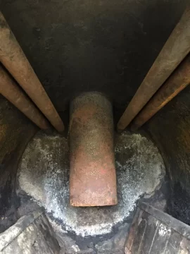

so I have a leak in the firebox. I was wondering if and what the four pipes that run trough the firebox do. Can I remove the outer two pipes and delete them to weld in a patch?

The pipes might be secondary burn tubes, you will want them if they are.

I'll get some pics in the morning. It would be easy if it was just a crack. The previous owner didn't clean the creosote from in between the outer tube and fire box about a 4"x6" section is junk and will need a patch. The fire box is in a little sequoyah whispering pine outdoor wood furnace.

Pipes run trough fire box. The water supply ports out of the rear are 6"higher than the tubes.

those tubes hold water from the jacket......if u cut them out you will have to weld a patch over the hole it will leave

Ok yes I understand that. Do those pipes connect separate tanks? Is the top front or back not connected without them or is it all one tank?
