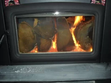

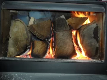

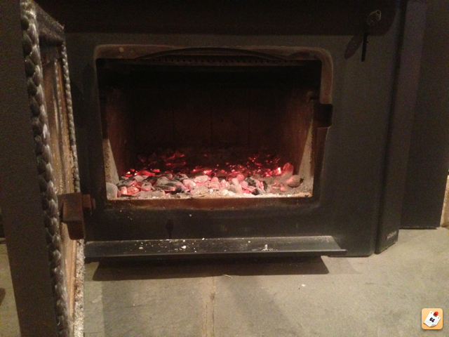

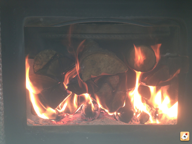

You want an overnight burn and then some, load the puppy full as you can.
Start with some bigguns, then fill in the top.
The baffle is the stopping point LOL.
This is just after reloading after just over 12 hours ago, on a level coal bed at 200 degrees stove.
Even 8 seasons in, the honing still continues. Less wood and more heat come from not only newer stoves, but better practices
Fire it up!

Major stove envy! I can only get 2 of those big splits in my little guy :)
That one on the right looks like it was on the bottom of the stack; A little moistish on that one edge. ==c
Maybe two of the big ones and one little one, if I packed it just right. Nice to have some Pignut and BL on hand so a smaller load will still go a long time. :cool:

Do you pack it and keep the air closed right away?
someday I'll get the *alls to load it full....I'm afraid of a runaway with a full load....maybe 4 splits at most:rolleyes:
Nada, full open air for about 15 to 20 mins to establish a nice char, and cook any moisture out(the one on the right), then cut air full low at about 450 degrees.
Those big boys need some time to get good and charred.
I usually cut the air to 1/2 for another 10 mins at around 300 degrees, but it was already up to 450ish, so cut it all the way back. Still lots in there, so will let it burn down while I am out on the road today.

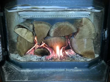

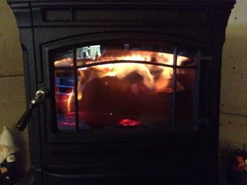

Your posted motivated me to get a picture of my load tonight...mostly medium splits....almost packed full.
Loaded up around 9:15pm, should be good till I load it up again around 6am with plenty of large coals left.
[Hearth.com] Load it up, burn all night....
Reactions: jaychino415
That is the way to do it. Enjoy

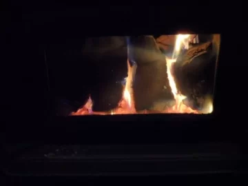

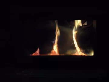

Me too.... Just loaded up at 10:00pm. Pulled the leftover coals forward from the load I put in at 8:30 this morning and packed it full with a bunch of odd-sized splits. Good to go till late-morning tomorrow.
