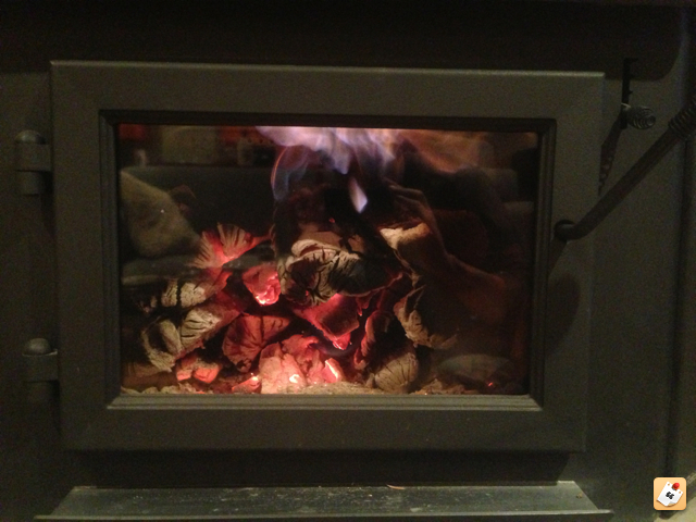

Well, if we are doing loaded pics...
[Hearth.com] Load it up, burn all night....

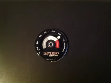

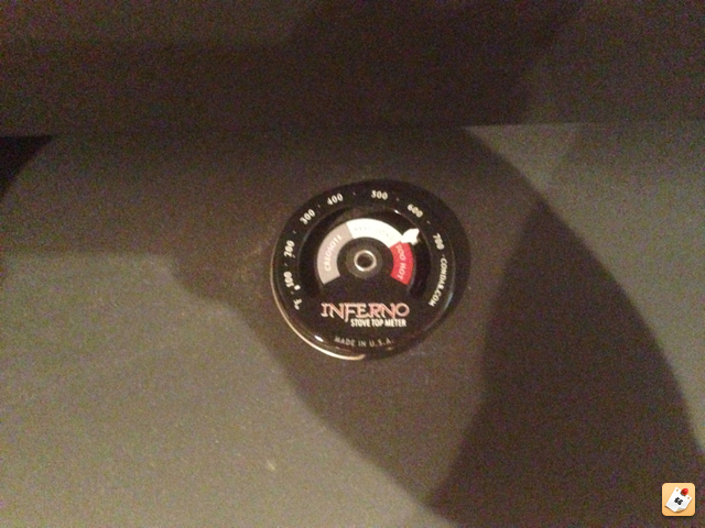

10:45, 650 on the stove top, air all the way down, and we are cruisin'.....

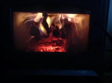

I'm giving it a go, but I can only stack E/W.
Left side is burning well. Waiting for the right side to catch....

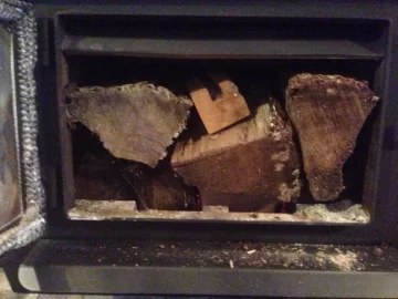

My little blaze king stuffed full. I would show a picture of it after it starts to burn but that would be boring. [Hearth.com] Load it up, burn all night....

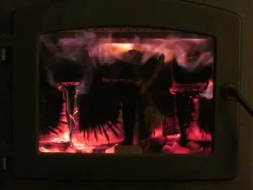

I have never had any trouble getting overnight burns with my Summit, Mulberry works well for overnight burns.
Just loaded up with 6 splits of mulberry an hour ago and now cruzing with the air all the way down.

Look at all that wasted space, load that biach up tight & full man! LOL Its a BK, it will last for days!
Whats with the lumber?
What kind of real world burns you getting out of her?

It is!!... Kinda hard to see but it is packed tight the bottom row the pieces are solid all the way across then the next layer is up the shield below the cat. There are no gaps just looks that way. That's as high as you can go because of the cat.
The lumber is from my work. It's the blocking that comes on our bundles of metal for spacing. Around 12% MC burns great.
With these temps to keep the house warm (70's) I have to load every 8 hrs. I have some heat loss issues I have to addresses and vents to put in to circulate the heat better. I think after that I would be able to go 12-14 hrs. I am also burning some not so ideal wood right now. The good crap is behind the wet crap.
