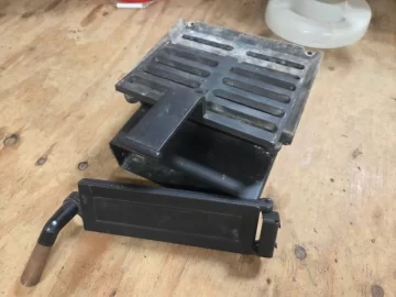

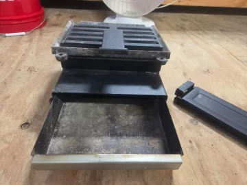

Let me ask someone with a Mansfield about the ash pan option, please offer an opinion to its usefulness.
When I noticed the back split didn't burn down on an overnight burn I considered it to be a great design, actually
As do I. My Craftsbury has a firebox so tiny that if the bottom rear most split were to burn up all the way I'd have no coals at all left in the morning to relight.
Hello, I installed a Mansfield 2yrs ago and had to have the ash pan. My installer had a used one but "like new". I got it for half price. Well it's pretty much useless. It really doesn't hold much ash and it's not all that user friendly. After using it for one season I took it out and it now sits in my shop.
It's much easier and faster to just use a square bladed shovel and carry it out the door to the ash can.
If you want to sell the ash pan kit cheap, I would be interested.

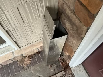

When the temps are in the mid 20s or higher ash removal is not an issue however when the temps plunge, I'm forced to remove some hot coals with the ash in order to re-load when the stove is still hot, it is the only way I can keep the house at a reasonable temperature, waiting for the coals to burn down is not an option. Scooping out ash and hot coals from a hot stove is not my favorite event, the radiant heat in the face, when the door is open, sucks!
Reactions: Todd
Well new the ashpan is $550. I paid $275. I think $150 is a good price as this is basically new.
