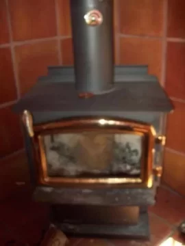

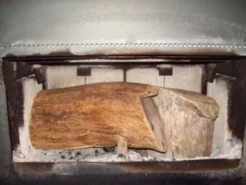

OK guys- here are some pics of how tight I'm packing...............

I drag all the coals to the front, leaving exposed firebrick at the back and bottom and drop the biggest quarter split piece into the back. That piece will burn from the top down and the firebrick will suck out enough heat to slow the burn so you have big chunks of blackened charcoal you can later bring up for air.
My friendly Oslo gets as much stuffed into as I can.
I make sure I cut my splits to near maximum length, that gives me maximum wood in the firebox.
I looked at your pic and I think you can stuff more into that firebox, for sure.
Thanks guys- I'm gonna work on stuffing more into the box. I talk with other wood burners at work and one fella says don't stack it to the top bacause ya don't want flames up the pipe might cause a chimney fire. I always thought ya want a good, hot punch up the chimney to shove everything out, assuming ya keep the pipes clean and creosote deposits to a minumum................

The only way you can have a chimney fire is if you have fuel in the chimney (because you have been burning too cool or unseasoned wood).
As for packing the firebox try weighing your wood. Allowing for ash and coals you should be able to fit 20lb of good quality, seasoned hardwood for each cubic foot of firebox.
I don't know about your regency, but my oslo, I burn it once a day at 600 to 650 degrees f. as measured by the thermometer on the stove top corner.....where the oslo manual says to put it.
I have a gut feeling the guys at work you're talkin' about may never have had an epa stove, have they?
I guess I can get a little flame up the pipe a ways if I'm runnin wide open but it ain't blastin up there like the old smoke dragons used to. Other than burnin' hot once a day, I can shut my air down with a packed load, shut it down half way when it reaches 350 or more if its burnin vigorous and then it'll rise to about 500, maybe 600 if I leave it at half air.
your EPA stove has a baffle so the flames have some traveling to do instead of the strait shot they used to have in the old non EPA models.
