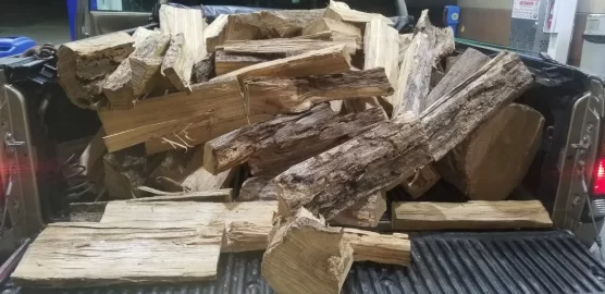

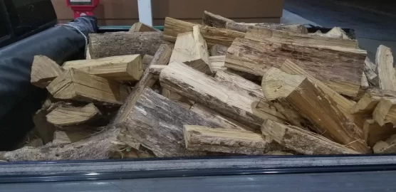

I can only be successful with locust when I load it on hot coals or mix with other woods, it will fight me if I try to make a fire solely using it or if my coal base is shallow. Other then that, I love the stuff and always separate it when I come across it, save it for those arctic blast times.
What you wrote is my exact same experience with locust.
BTW...I Loves Locust!🤓
Here is a haul I picked up Friday night!
