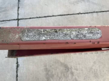

3. Can someone identify the Model? Pics to be posted in a few. I need to go get some good ones with the "tag" in them. There seems to be no actual identifiers on it. So I'm hoping someone knows what it is. I "know" it was at the least built by MTD. I haven't found any model or serial number on it anywhere.

If you have serial numbers you can go to the MTD site and sign in then enter your serial numbers so you can get your model number.

If there is a serial number I have no idea where it is

The engine has one and my splitters serial number was on the back of the hydraulic oil tank, the side you "wood" be looking at if you were splitting vertical.

I think this is the way I found my model number.

The stock engine was replaced prior to me getting it. I thought I had seen a plate on the tank but didn't see it today. I'll look again.

I posted a link above to MTD, if you can't find your serial number, maybe through pictures and contacting MTD, they can help.
