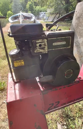

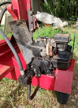

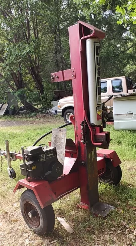

Got the flywheel off and discovered a fractured key on the crankshaft. Also discovered the motor has no points or condenser; after a little research I found the motor has a magnetron ignition system. I am guessing ~mid 90's manufacture. Looked again for model/serial # but it still eludes me - have looked in all the likely places. Maybe one day after I stop looking it will jump out at me.
Here is another attempt to upload pics of the old 22 ton Duerr.

Found a few search hits that might help out
Yeah that motor is newer than what I had pictured in my head. I sure wouldn't go too far considering a five horse Predator from Harbor Freight isn't big money and they run well

I wouldn't spend the first dime on that motor. Watch for a HF sale and go pickup a 6.5 HP Predator and be done with it. Those years of BS engines weren't the best when they were new. Had several on two inch water pumps and they were a pain to keep running. I have a lot of Predator engines out here on the farm and have not had any issues with them.
I would look on FB Marketplace for a failed pump pressure washer with any of the Honda GX series engines on it and poach that engine over to your rig. Like Hedge Wood noted above those B & S engines aren't the best built out there, Had a 5 HP B & S on my splitter when I bought it in '92, it lasted about 6 years then completely died. Found a place with several Honda GX200 series pressure washers with failed pumps and have had great luck with one, cost me about $100. I can find failed pressure washers with Honda's on them for $50-100 around here.
