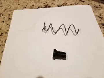

So I pulled off the Straight Fitting that connects the tank to a hose that goes to the inlet of the pump. There was a piece of plastic that may have been a reverse flow check. It was positioned in such a way that it was restricting flow to the pump. It was moving back and forth with which ever way the flow of the hydraulic fluid went. I can't find this piece in the schematics.
From an older post I believe may be a one way check flow valve. I put the splitter back together and it was operating like it should. I think it actually extends and retracts faster. I put a piece of wood sideways and it pushed through. The engine doesn't stall and when returning the valve release when it reaches the end, like it is suppose to. Spring was found in supply tank and the black plug was found in the end of the supply hose closest to the tank. I assume that these closed off the supply tube so that fluid stayed in the pump? This part is no where in my parts schematic.

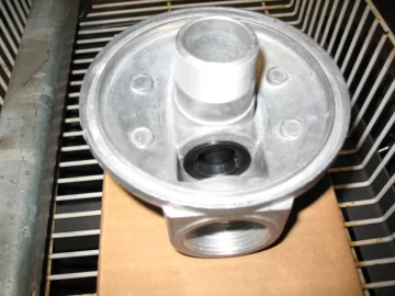

Filter by-pas

triptester has it dead on- need a new filter housing assembly. Many eons ago I had one where the bypass section went south and jammed up the works- found out about it when the pressure built up enough to blow the filter housing assembly apart. Maybe two hours on unit. After finding the pieces I came to the conclusion that the housing assembly had been installed backwards by the oem. Most have an arrow indicating flow direction ( should be pointing at tank - this one was not). Trials and tribulations of Chi-com mfg equipment.
Reactions: kenc18901
So that bypass "plug" and spring puked out of the filter head and into the tank? and then this junk made its way to the pump intake hose? I thought there were baffles inside the tank. Either way, good find!
at least it did not make it into the pump proper- than would have been a real mess.
