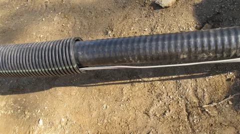

thermopex (CB 1.25) I stuck it inside yet another pipe, wit power ! [Hearth.com] logstor vs. thermopex vs. other

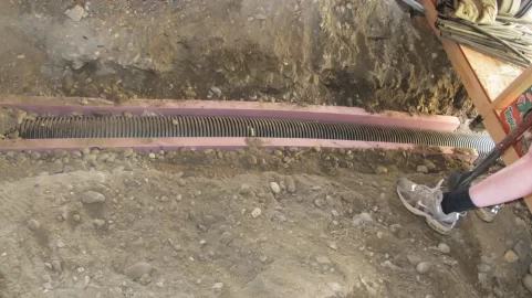

then I ran some more foam in a 2 legged "t pattern" (I placed another 2" foam on top) .....works good .... this is where its the shallowest ie solid rock under the 12" of dirt/gravel at this point of my pipe err the last 14' of it anyway! [Hearth.com] logstor vs. thermopex vs. other
