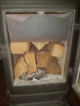

Yep, this is the cause of super short burns. Also loading the wood in a crib style will also accelerate the burn. I load my Morso as full as I can. If it's a cold start I'll even play around with the load until I have gotten as much in there as possible. This means wood against the baffle. Some stoves have fragile baffles, so keep this in mind and be gentle. I have no pictures before a light and it's too warm to use the Morso right now. I'll try and remember to get a pic.
Not very big I usually put an big one in the back a 3 " round in front of that then a couple little ones on top
Load the stove full. The way you are loading leads to lots of air and not much wood. That means short burn time

Load it up. My insert is only a little bigger than yours and I cut a lot of my wood 13" long for when I need to maximize the space.
Your wood is higher BTU than what I have access to, but I still don't think you'll get 6 hours from such a small stove.

Your wood is higher BTU than what I have access to, but I still don't think you'll get 6 hours from such a small stove. View attachment 254058View attachment 254059
Thank you for the photos. I definitely don't fill it that much. About half that is what I'm doing. Lol I need to my skills and start loading more. How long dose a load like
that last? Thanks

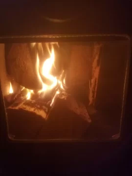

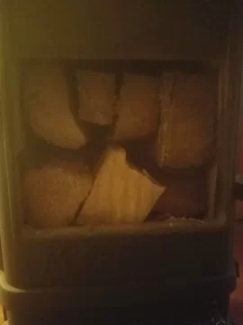

Obviously not the same stove as you, but I generally try to get it as tight as possible. Inevitably there are always enough gaps for air to get through, despite my best efforts. This is all spruce and fir and should yeild usable coals around 0700.

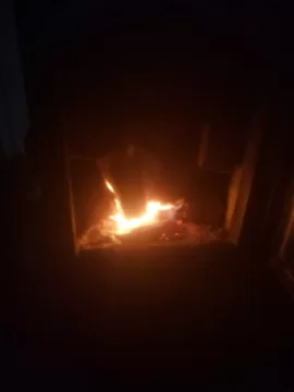

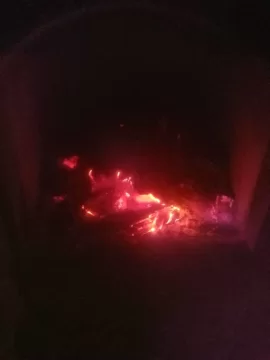

Sure enough at 0730 I have a nice pile of coals and my fire has restarted. I went to sleep and the house was 73df in the stove room and now it is 64df. If it were a colder night (sub 20df) I would have loaded up the cook stove as well or used a load of maple or birch in one or both stoves. Usually I don't put hard woods in my cooker since it's not as efficient at heating the house, however we had 0df temps last week so I pulled out the stops. We are also missing a bit of insulation downstairs and the upstairs insulation has been torn up from mice and leaks.
