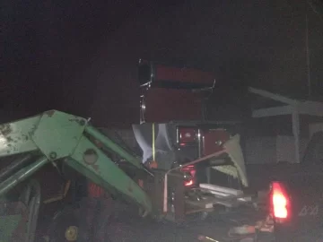

Got the stove back last week. Having a tractor to unload sure is nice! I was away most of last week so I didn't have much time to work on it. Have several hours into it already getting it cleaned up. The stove top needed a lot of work. My oldest son saw an opportunity to run power tools and volunteered to help!
