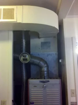

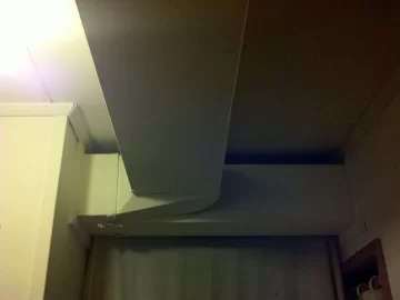

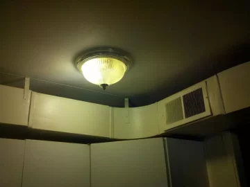

The furnace is used, the dealer I'm buying if from had it set up as a show unit. I'm going to leave the Oil burner where it is and put the furnace in another area of the house and just tie it in to the ductwork. My oil furnace does not have cold air returns it just blows directly into square ducting. I have a simple single level home with no basement and the duct work basically in run in a big loop, minus one split off for the bedroom and bathroom areas. I'm attaching pics to give you an idea of what I have now. I don't know any of the terminology, but I hope the pictures give you an idea of what I am working with. I thought about saving you from pics of the old thermo pride oil burner, but I don't think it will be to tramatic.

You want to minimize horizontal runs in your 4" pipe, as well as minimizing the total length of the pipe overall. PL venting is expensive; keep in mind that elbows, Tee's, and horizontal piping add resistance to your exhaust setup, there are formulas out there (for example, an elbow is equivalent to 5' of vent pipe in terms of resistance). Your furnace should go where the PL vent is minimal length to go up and out of your house, don't worry about having to run extra ducting, ducting is MUCH cheaper than PL vent. You will need dampers to tie into your existing duct work. You may want to consider cutting a couple vents into your floor and direct ducting your furnace, it's the least expensive option IMO.
Yes you must run dampers when using existing HVAC.

I would like the leave the oil furnace alone, but I'm not sure how to block the heat from going back into the furnace.. The ductwork is a huge box.
That's what a back-draft damper does. You need one for the Fahrenheit, to stop air from the furnace/central air, going back into Fahrenheit outlet. And one for the furnace, to stop air from the Fahrenheit, going back into your Furnace. They are just a simple damper. The dampers I have, are like a butterfly valve. When either unit kicks in, it opens the damper on the top of it (naturally opens because of air pressure) and the incoming air in the system closes and applies pressure to the other damper. So only one unit can be ran, and it runs efficiently, by not letting any heated air escape through the other unit. Sounds much more complicated than What it is. I will try and get a pic of one when I get home this evening.
Do they make dampers for rectangle vents? This would be easy if they did.
Yes they do. You can buy them or of you know someone who does HVAC, they can make you one. But they do sell them, in all shapes and sizes.
