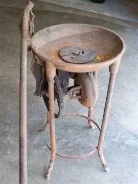

This is the second time in 3 months that I have heard of someone wanting a small forge...and to think that I passed on two "portable" forges earlier in the year at an estate sale. They went for scrap price.;sick
This was the style:

this is no forge sir...is one of my early designs for the "fire bidet"....did not go into production. still tweaking idea.

That's a "rivet forge" Jags. They were carried up in the skyscrapers one floor at a time, before welding took over. They are of course, useful for much more than rivets, though limited as to size overall. I have had a couple over the years, they work fine.
I have no doubt that you are spot on. Around these parts it was a common site to see farmers with them back in the day. I think they were used like portable Lincolns along with their "anvil on a stump". I had another old timer tell me "horse shoes", but that is way before my time.

No doubt they were used by other trades as well. I had one in my welding shop 30 years ago before I even stared blacksmith school. I am sure portable forge is as good a descriptive term as any. Next time you see one cheap buy it, they can be used for so much. I do small melts, forge brazing, all kinds of bending (that any fabricator not just a blacksmith) would do. I know you do some welding, you would find it handy. You can also easily make your own high quality fuel; the best forge fuel is charcoal. My son often uses my charcoal forge for melting lead. The main thing is, oxygen has gotten so expensive that anything that can be done with a forge instead of a torch saves a lot of money.
