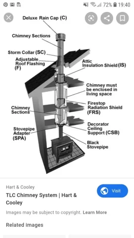

I don't think we are being clear, you can go straight up regardless of where your masonry chimney is located. You can put the stove nearly anywhere you want, provided it meets the manufacturer's clearances and you have adequate room for a chimney. https://images.app.goo.gl/HkdM6wYb3DMoZmMW9
The link is an example of one brand of chimney, I just picked that one because it has a good view of what they look like.
I was confused af first but now it makes sense. That would only work if I had a single story house, I have a Colonial so can’t really go up through the ceiling
Why not? Just build a chase around the chimney. I would go up with mine, but there's a bathtub right above where I'm placing a stove.
This company has awesome graphics, but I've never heard of them before. Anyway, you could run it up the wall with a chase around it, run it through a closet, or maybe make a closet. There are options regardless.
