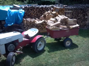

I'd consider either making a counter-weight for the front or something of the like, if you are going to drag a plow....maybe even make up some weights for the front wheels too. Also, those Suburbans came with more of a turf tire. I'd be making a set of chains for the tires if you are going to be plowing dirt, Jay.
Or you could go drop some coin on a set of tiller lug tires for it! I'll be buying those for mine soon, as the tires are starting to show their age....
Pic of my old Sears Suburban........use it all the time for processing and also even on some of our tree jobs....

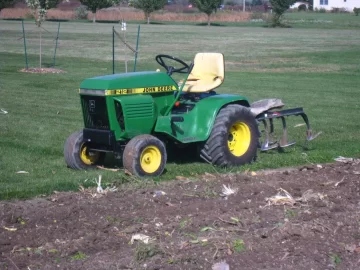

Not a particularly original suggestion, but what about an old John Deere, like a 212 or 214? Deere made a ton of them, so there are enough around you can buy them cheaply, find replacement parts easily enough, and find attachments without too much trouble.
I have a 212, and love it. I have a front snow blade, 30" tiller, and a sleeve hitch with a 10" moldboard plow, disc, and cultivator attachment. I abuse the snot out of that tractor, and it keeps coming back for more. Lugged tires, wheel weights, and hydraulic lift, and it's a beast. Attached pic is pre-hydraulic lift but from last fall when I was tearing up the garden for the winter.

Been working on a mint 212 awesome machine. So is the 214 and 216. Oh and yours is what one I would love to get ahold of. Just hard to find a nice one.
