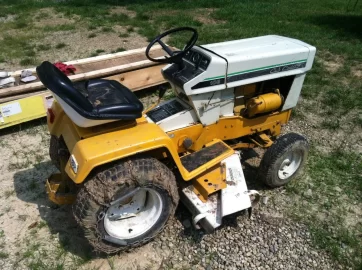

Got it runs good hydro all works good. I thought this model was a 10hp but seems its a 12hp.
Reactions: MasterMech
Someone changed hoods or engines. The 108 is 10 hp.
Sure you didn't bring home a 123? Post a photo.
Reactions: smokinj
Its clearly a 12 hp. The guy told me(because I am thinking the same thing) With the hydro system the 108 came with a 12hp kolher.
There's more here than meets the eye. If your machine looks like a 108, but has 12 hp and hydro, then it's a 129 wearing a 108 hood. Same frame, tractor, etc... just a different engine and trans, which dictates the model #.

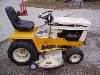

Is this your tractor, with a different logo on the hood?

See if this helps any? It is a 3 speed but the deck and back hitch move by electric. Iam starting to think 128 or 126. When I said hydr I was talking about the deck and hitch lift. But I guess its electric.
That's a 128! The 126 was the old narrow frame design with cast grille and separate hood.

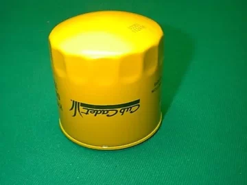

Here is exactly what I bought, both at ccspecialties.org. Filter was $14, fluid was $29/gal. Requires just shy of 2 gallons for a complete change.
[Hearth.com] Looking for a vintage lawn tractor. [Hearth.com] Looking for a vintage lawn tractor.
Reactions: smokinj
Expensive fluid, but the good news is you won't be changing it every year. Most folks go many years with the same HyTran fluid, just changing the filter yearly, if you keep the water out of it.

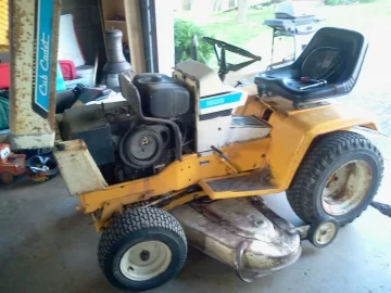

This one is 43 years and I don't know where she been. Looks pretty muddy to me though. ;)
