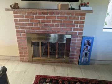

Hello Everyone - I just joined today, looking forward to learning more about wood stoves and how to use them the right way. First things first - I have to find one and I seem to have VERY limited options. I have an existing fireplace without a damper that I want to make functional; the fireplace is located in a long, narrow living room. During the search to find out options, I ran across the Biomass Tax Credit, so I thought I would try to take advantage of that at the same time. The problem that I am running into is that the area that would be heated is roughly 900 sq. ft. and I can't seem to find much to fit the current fireplace opening (a must), that meets the Biomass Tax Credit efficiency ratings, and is right-sized for my area. I assume that I should be trying to stay as close to 30,000 BTU as possible. The winner so far seems to be the Vermont Castings Intrepid FlexBurn (which are not sold in my area) and I can't find any fireplace inserts at all. My fireplace dimensions are below for reference. Does anyone have any suggestions of a good quality wood stove or insert that would work? Thanks in advance!
Height: 30 3/4"
Width: 27 1/2"
Depth at bottom: 23 1/2"
Depth at top: 23 1/2"
Height in back of fireplace: 26 1/2"
Width in back of fireplace: 24 1/2"
Do you have a picture of the fireplace? Not having a damper seems unusual. How does the living room connect to the rest of the house?
Hello EbS-P, Here is a picture of the fireplace.
[Hearth.com] LOOKING FOR A WOOD STOVE OR FIRPLACE INSERT
I think the Hearthstone Castleton will fit in that space, and it's EPA certified. I haven't ever used one, but ran across it when I was looking for a stove for a similarly-sized opening (pretty sure I had those exact same doors on my fireplace =P). I ended up building out the hearth and putting my stove in front of the fireplace instead - better radiant heat transfer throughout the room and it let me get a side-loading model. I'm surprised you haven't been able to find any inserts - I didn't want to go that route, but it seemed like every chimney guy I talked to wanted to convince me to put an insert in.

How is this room connected to the rest of the house. have you confirmed you have full masonry fireplace and not a zero clearance fireplace?

Hello EbS-P, Sorry, I missed your post. My house is U shaped and the fireplace is roughly at what you would envision as the bottom of the "U". I would not expect that the head would impact the 2 wings much.
