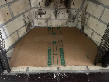

I cut out a template of a wood stove I’m interested and placed it into my fireplace. It seems like it should fit, but the tolerances are tight. Does anyone have input on whether it should fit or if it is too tight?

What insert is this for? Does the back of fireplace go straight up, or is it sloping?
The template is for the lopi medium flush insert. The fireplace back slopes out and back in towards the room. After lifting my template up 22” to adjust for the stove height, it does not seem like the stove would fit without modification to the fireplace. One installer mentioned that there is not much space behind the fire brick, that behind it is structural masonry.

I think the rear venting freestanding stove is a good solution for some. I’m sure I’ll miss the radiant heat I had with my previous free standing BlazeKing Ashford. I don’t have the floor room at this new location for one. My wife prefers the look of the flush inserts. I want to maximize stove volume. It seems like the BlazeKing Princess and the Lopi Evergreen should both fit.

What is the fireplace depth at 21" off of the hearth floor?
Measure twice or thrice.
This is a difficult measurement to take. The height at the front seems to be a little different than the back. But I’m measuring 18.25” depth at 21” height off the hearth floor at the back. The lopi medium flush height is 19.75” at the back.
That seems like a no go on the Lopi Medium. I know its hard to hear, but consider all that needs to occur, the unit has to fit physically and have the liner connection work as well. Is the damper opening at the back of the fireplace, or more towards the front? Sometimes a smaller insert that can be installed properly is the best choice, the first time around. Please remember too, the installer has to get their paws in there to install the unit and liner... Good luck.
Thanks stovelark. That makes sense to me, and it is reassuring to hear this a second time. This was also a similar position that the installer had.
