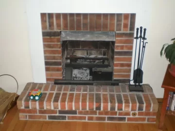

Is this a masonry or metal pre-fab fireplace. Hit us with a few pictures of it.
Masonry. I'll get some pics and post em this week.

Here's a pic. The silver thing on top is my attempt at a hood to keep it from smoking. The grate is a "Cozy Grate". It is a cradle made of square tube. There is blower in the square on the right and air passes through the tube and the outlet is on the left. The blower is controlled by a rheostat and comes on when the grate reaches 110. The blower is tolerable at low speed and obnoxious at more than 50%. It is made to work either in an open fireplace or with doors. It is NOT a substitute for an insert.

No, it's not, and I agree that you are on the right track with an insert.

I gotta tell ya, my fireplace had a "smoke shield", it didn't work, either :smirk:
