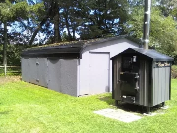

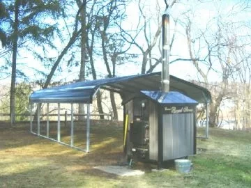

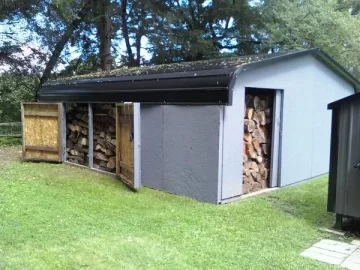

For $800 plus tax, you can buy a TNT Carport that is 21' x 12'. These are NOT the cheap carports that fold up in a storm or hard wind. They are VERY sturdy. The man that sells them in my area has had the same one set up for over 6 years. It has seen some MAJOR snow storms and extreme winds and it is still standing and not a mark on it. He purposly DOES NOT clean the roof in the winter to show the strength. Now, I wouldn't recommend that, but it is good for advertising. I can't take credit for the idea. My buddy had one installed 3 years ago and when I saw how well it worked, I bought one.
I know what you mean about the tarps and the snow. My first 2 years I fought with that all winter. Not fun at all. This year I just go out and grab the wood and throw it in the stove.
I enclosed mine with sides, except fot the back. There are doors in the front and side that open to allow for air circulation while drying.
I don't knowhow much you want to spend, but if you add up the cost of lumber and any roof supplys you have to buy, this may be a good choice for you.
Mine is 18' x 21' and here's a few pics.

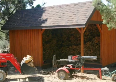

I kinda went over the top with mine. It needed to look pretty nice, as it sits very close to my house, and is in full view when you drive up to the front door. It's built off the ground, like a deck, and all the deck and siding boards have generous spacing between them for good air circulation. The face you see in the pic is the east side. Even with three solid rows of stacked wood in there, I can see the sun peeking through between splits in the evening as it sets. Our weather comes generally from the west and we often have sideways blowing snow (like we did today). This shed will hold nearly 8 cords (theoretically), more practically about 6 1/2 or so. Space under roof for splitting or whatever. I have a good deal more wood elsewhere on the property, most of it uncovered, for future years. (If I'd taken a pic of the shed today, you'd see it in a winter wonderland). Rick

fossil, that's one of the nicest looking wood sheds i've ever seen. Just seeing that will serve as inspiration on how I'll want my shed to look.
Great looking well built shed Rick!!
Real nice woodshed you created from a carport... I did price them online and they go for about $1000 installed around here.. Is yours certified? I noticed some are and some are not.. Lumber is very expensive and my shelter set me back about $1000 and that was built on my old deck..
How much did it cost you to enclose the sides?
Ray
Yhe difference between certified and non- certified is 12 gauge or 14 gauge. Not a huge difference. Mine is not.
I had some lumber left over from an old deck also and I used that for the framing on the front. The rest cost me apoox,$120
