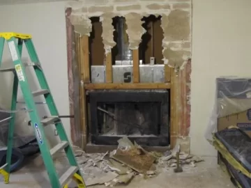

remodeling living room. house was built in early 80s. fireplace needs replaced fire box is small and cracked etc. should i just demo the fireplace and put in a stove in the corner? any other ideas?
That's what I did. It was dusty work, but no regrets.

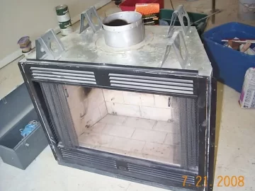

I had a builder's box fireplace in the corner of the great room. Pulled FP and enclosure wall out. Put tile and stove in. Sold builder's box for $150. Does yours look like this?
