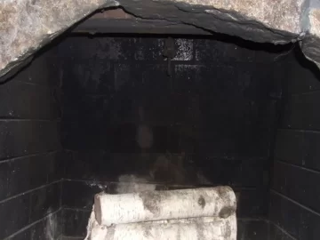

In order to get the liner attached, it may be necessary to have the stove about 1/3 into the firebox. I would definitely install the liner with a block off plate set as low as possible to reduce heat trapping in the upper part of the fire place opening. The location will be easier to determine if you can post some close up shots of the fireplace and the damper area with the doors removed.
pics

Great, that helps. See the metal lintel? If a blockoff plate can be installed at that level it would be most effective.

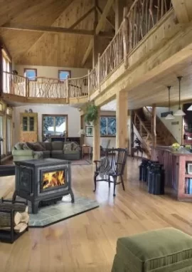

Here's a few curved top fireplaces from folks at hearth.com... some of these are stoves and some are inserts (without the surrounds, but you could also put a surround on it and get the surround cut to set just inside your rounded opening.)
[Hearth.com] looking for insert, Fireplace is too large
that's drdoct's setup.
(broken image removed)that's redguy's setup
random pics I found on the internet

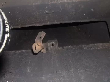

I measured the throat, it's 5 1/2", but there is a bracket right in the center of it that sticks out about 2". I think I'll have to offset the Liner somehow or route it around the bracket.

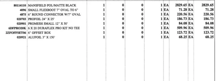

Wow, just went to a local stove shop, the Mansfield is a little more money than I expected. Everything came to about $4,000 if I install it. Do these numbers look reasonable?
  • [Hearth.com] looking for insert, Fireplace is too large
That's a great price on the Mansfield. Usually starts at $3400 for the matte black.
