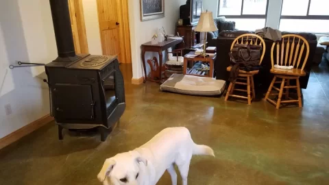

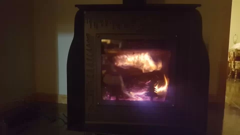

when building our 1500sq single level home here in Missouri last summer I located the woodstove centrally in the floor plan.
It came down to a choice between the BK Ashford 30 and the Woodstock Absolute Steel.
I ordered the AS in the spring at pre production pricing and couldn't be happier.
I have heated exclusively with wood this winter using 1.1 cord of seasoned oak thus far.
burn time? Honestly I have never loaded the stove all the way up to test it for anything beyond 12 hours. It puts out more heat than my well insulated house can take on the front side of the burn cycle if I do. I think this would be True with any stove. Unless your willing to tolerate cresote and smokey chimney. (I am aware of BK claims)
but if you need the heat on those cold days? No problem!
this thing will crank out the BTUs when needed.
if loaded and going the secondaries kick in beautifully for a little while. First hour or so. Then the catylitic burn takes over from there for the rest of the burn cycle.
the glass blacks out everytime. Stove top Temps of 400-500. For 6-8 hours then slowly goes down from there (the way I've been doing it).
I have removed exactly 10 gallons of ash and cleaned flue on Jan. 1st. Which yielded 1 quart of flaky creosote. Hope this helps.
