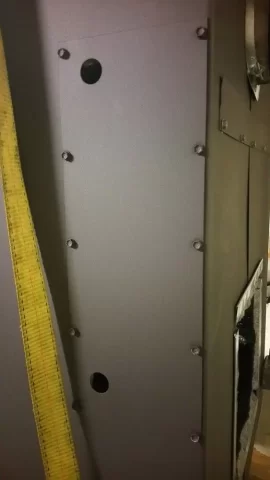

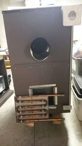

I received my VF100 today. After a bit of time with furniture dollies, an engine hoist, 4 wheeler, some chains and snatch-straps, we managed to get it in the downstairs. I'm super excited to get it installed and fired up. To quote my dad (who helped me get it in ), "It's a lot smaller than that Clayton we used to have!" To hear him talk about how much wood they used to go through, I think he's curious to see our results.

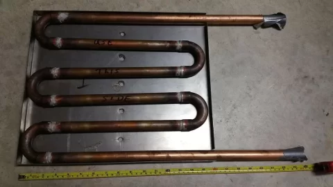

That being said, I'm quite underwhelmed by the water loop. For a $300 accessory, I expected more. It's essentially a 16" square loop of 3/4" copper pipe. Here is the coil:

Relative size, compared to the furnace:

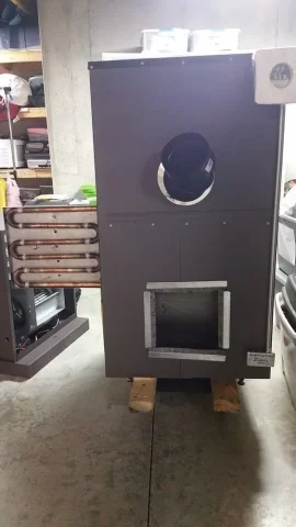

Installs like this, except inside the furnace:

Access panel, on side of furnace (it's hanging from these holes in the photo above):

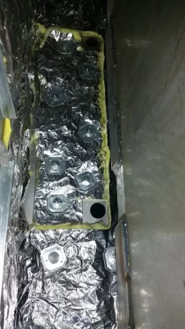

Here's what the access panel looks like from the inside (photo taken through the fresh air intake hole):

The backside of the stove, where the water loop installs, is wide open space (with the exception of the flue stack). I think it would be easy to have a heating loop that's 4, 5 times the size of this one. That's more what i expected. I don't know if I'll get to it this year, but I suspect I'll be pulling the enclosure off, and installing my own water loop, fully utilizing the space at the rear of the furnace. There's a lot more space to utilize, and I see no reason not to do so.
I don't expect the water loop to replace a hot water heater, and that was never my intention. My plan was simply to have the loop feed a holding tank (80, 100 gal) to pre-heat water prior to the water heater. I don't know how effective a water loop of this size will be, but I feel strongly that it could be much more effective.

I guess my issue is more about the price charged for what you get. It's still $300 for a 16x16 copper loop, a panel cut in the sides, backing plate for the loop, and 4 studs welded to the firebox.
I know Daryl has an amazing customer service record, and I know he's been tweaking his design for decades. There's probably a very good reason it's sized the way it si. This is my first wood furnace, and hell, it's not even installed yet. I may hook it up and find out the water coil is -perfect-. I don't discount that possibility. The "kid opening his Christmas present" aspect just took a hit when I saw that loop, that's all.
