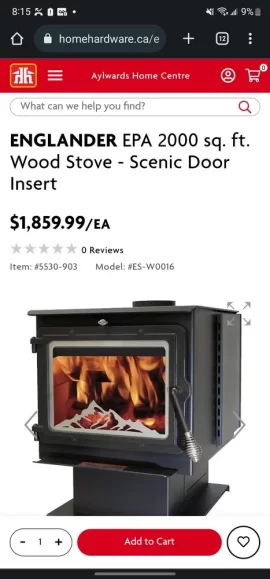

There is an englander available at home hardware. I was looking at it today but they're prices are considerably higher than anywhere else. The price there is $1859. Is there an optional blower that can be purchased for those?
Wilcoroger

Sorry it isn't actually the 32-nc. And there's a offer for a free blower with it

Englander got bought up by SBI just before this model came out. Performance unknown. They had issues with door warpage on their big stoves of this generation in the past. It's also unknown how well this has been sorted out. The 32-NC does not have this issue and is a real workhorse. It was selling for $998 here in the states.

I'm definitely going to check into the englander more. I found it on a website for $1449 with free shipping. I'm sure I can buy a blower for it as well. Thanks a lot for the info

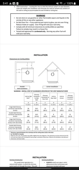

Note that the clearances for the 32-NC are substantial, about 22" for the side with double-wall stovepipe. It's a heat monster. The Legend III and Myriad have better shielding with side clearances of 10" with dwsp. They can be reduced even further with proper wall shielding.

Looks like it will be a corner installation if I do go with that stove. I can get the corners down to 8 inches. If I use wall protection maybe less. Ive gotten the fire chief's input on every unit yet so I'll get his input again on the next one as well.
