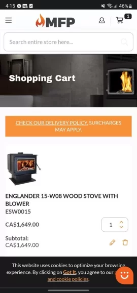

What's your guys opinions on this unit. It says up to 14 hours burn time. Also clearance on a corner install is 5 inches without any other shielding.
Same as for the previous inquiry. Unknown if they have solved the door issue.
