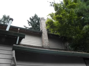

yeah that will take some cutting but not to big of a deal. I would just do away with the arch if it was me. You will also need some serious cleaning before doing anything that is a messHere we are, thanks again.
