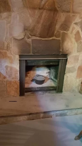

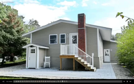

Thanks everyone for your speedy replies. Here are the only 2 pictures that I have immediately available. The fireplace is in the basement and the chimney has some tar flashing near the roof as well as steel bands to help secure it to be home.

Yes, the 10-13k is for a new fireplace box and new chimney. the way I understand it is that it's a 1 unit piece that they will replace in full. We're wondering if there are other options than just replacing it. Perhaps a gas unit is a possibility?
From a distance it seems like you could put a stove on the hearth (maybe have to add to it) and run a new liner up the existing chimney. That and a budget for a few repairs to the masonry chimney ought to be a lot less than the quote you got and you'll have a proper heater.

Did the old fire place draft OK? Basement installs can be tricky so you want to take steps to give yourself the best chance for success. Another on-site evaluation with your new ideas might be a good idea to see if this feasible, there's still some things to consider.
There is gas in the house already. At first we were just happy to have a fire place, but we do like the idea of it being more functional than just ambience, hence the thought of going gas.
Gas logs are a possibility as is putting a freestanding stove (wood or gas) in front of the fireplace. The later option will depend on the fireplace opening height above the hearth. The opening has to be higher than the top of the flue collar on the stove.
The quote you got sounds appropriate for replacement of the current unit with a modern EPA wood fireplace. The current fireplace and chimney would need to be removed and replaced.
no gas logs need a functioning chimney and firebox. If it is as bad as he says gas logs are not an option either. And honestly if it is deteriorated that bad I would not install a stove through it either.
I don't like them but vent free logs not an option?
If you are ok with a gas fireplace then it would be worth getting a couple quotes. Even with a full replacement a gas fireplace may end up costing less due to lower chimney and fireplace costs. The labor I expect will be close to the same.
