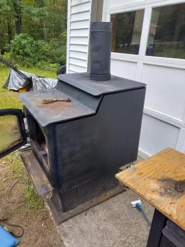

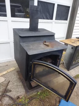

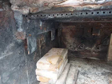

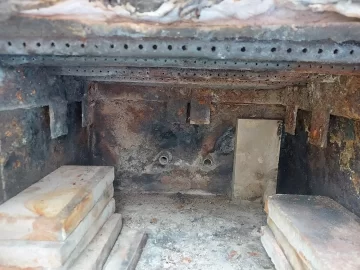

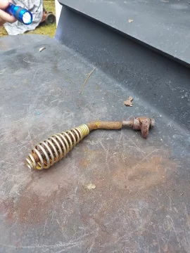

I saw the stove and will post some pictures. Perhaps those of you familiar with this unit may be able to guide me in it's overall condition. Surface rust, a broken door handle...not sure how expensive that is to replace? It is a 2002 year model. Also I will put this on an existing hearth if I buy it, but does anyone have suggestions on how to pull this big heavy stove back from the hook up pipes to clean it out 2 X a year? I am concerned that it weighs around 400 lbs and would most like damage the tiles and pulling 400 lbs back and forth twice a year to clean it out may get old. Is there anything folks put between the stove bottom and the hearth to facilitate reducing the friction and impending damage?

The handle is about $70
The stove doesn't look too bad but can't really see the typical problem areas.

Did you pull the side shields and check main stove body for cracks as BHoller suggested? I see you answered this while I was typing.
I see BHoller has posted, so there’s the cost to fix the handle for $70. I’d be sure nothing is wrong with the door itself because the price goes up from there.
I wouldn’t want to steer you wrong, so I’ll defer to BHoller, but those bricks don’t look like the current pumice bricks they now use. I’m sure Ben will know if they’re the correct bricks or not. I believe the lighter pumice bricks have different properties than the more dense clay bricks. He can tell you if it matters.
Unless that stove is going to cost you less than $300 I personally would pass because of the known issues. Not saying it isn’t worth more, rather it wouldn’t be worth more to me. For someone else $700-$900 might be a better figure.
I’d want the newer ACC version, but that’s because I’m more familiar with the newer model.
I’d also want a working blower, even though the design will move plenty of air on it’s own. Seems I recall Quad saying stove must be used with the blower though…which I find odd…and if true I’d want the Lopi Liberty stove instead. Once again, Ben may know and may be able to confirm if the blower “must” be used when burning the stove.

Those are not the correct brick no

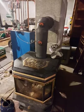

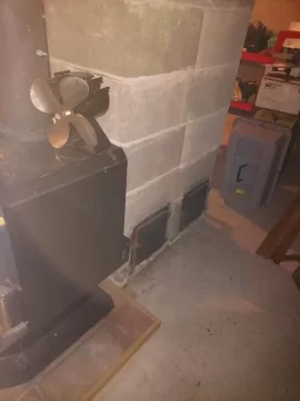

I have been pulling the Osburn away from the chimney and cleaning the pipes going to the stove and then of course upwards into the chimney. Could I use the clean out access door to clean the chimney and leave the stove connected?

It does have a working blower on it, but looking carefully at the pictures I see some significant rusting on thatheat exchanger unit, coupled with the wrong bricks perhaps and door handle....I may just keep the Osburn 1800 another season and make sure I am using a moisture meter to get the best seasoned wood into it to see if that increases my burn time / heat.

Bricks don’t coat much, but the rear bricks will have pre-drilled holes for secondary and tertiary air. I’ve not been impressed with what I’ve seen of the bricks in hundreds if these for sale. Generally they’re toast. Now whether or not that is from long use or abuse (frequent over heating of the stove) I can’t say and will again defer to BHoller.
Rust on air tubes from a stove sitting for awhile isn’t much concern for me. Replacement costs might be a concern. Hard for me to see the tubes well enough on this phone. BHoller will likely know if these meed replacing and oerhaps a ballpark price to replace.
Stoves of this design naturally move a ton of heated air. If it has a working blower that is a plus. Not working figure $300-$400 replacement cost as a stab in the dark. The blower for your SBI stove costs much less than the Quad or my Lopi Liberty…which by the way on the outside is nearly identical to that Quad.

The Quad looks neglected. Like it's been in a damp area for a while. Personally, I'd pass on it, especially when one can get a brand new Englander 32NC for $999.
