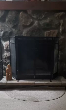

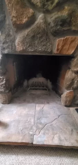

Hello everyone and thanks for reading my post.
I am looking to install a woodstove in my fireplace. I am currently looking at the vermont casting dauntless. I was looking at the specs for clearances and it appears my mantel is 2" under. In the manual it should a 12" (from the wall) mantel. However, my fire place has stone to the mantel so there would be very little lip under the mantel.
Question 2, do I need access the back of the stove to? From my research it looks like I would need to install a T to sweep the chimney. The wood stove would leave me with a couple inches on each side.
Question 3, when we purchased the house 5 years ago the chimney was lined with a new ss liner. Do I need to install a new liner or can I just stub a piece in?
Thanks for all the help

That looks similar our fireplace we just had a Dauntless installed in.
As far as I know you would only need access to back of the stove if you had to take the heat shield off to fix something. I would be more concerned with side clearances. With our install, the bypass lever just clears the side of the fireplace. I can see myself getting a few burns if I don't use a glove to control the bypass. I also can't install a cat probe unless I pull the stove out, which I'll have to do once things get inspected.
As far as the mantel clearances, the manual says you need 27.5" of clearance if the stove sticks out of the fireplace, with a maximum projection of 12". If it sticks out of the fireplace more than 12", I don't think you can use the fireplace installation clearances. Our stove sticks out by about 4" and is 27 5/8" from the mantle. I might still put a heat shield up to be safe. I will defer to someone with more experience for recommendations on the liner.

Is this an interior or exterior chimney? I ask because any hearth installed stove probably should have a fan and any exterior chimney should be insulated, that really means you should have an insert.
vernorz
Aug 26, 2021
43
Massachusetts
I'm not sure if this is a question for me or the OP. But this is an interior chimney with an insulated SS liner. There were no inserts that would work with this fireplace due to the shape of the firebox, very shallow and tall plus the angle of the side walls.

Hi Deere-nh. Given you're in NH, I know it's just as likely that any masonry fireplace may be central to your house, here in PA they tend to be always on outside (gable end) walls. I mention this because any stove installed inside a fireplace should be of a design that radiates very little heat off the sides, as the masonry is going to suck up the majority of all heat produced by the stove, in this installation type. If the masonry is completely central to the house, then this is a non-issue, perhaps even an advantage. However, if the masonry is connected to an exterior wall, much of the heat you produce will be pumped out to your back yard.
begreen will tell me I'm being too hard on Vermont Castings, holding the (numerous) sins of their recent past against the current company, whose products and customer service may not be quite as terrible as what they've had over the prior ten years. Perhaps he is right, but I still cringe every time I hear anyone even mention the idea of installing VC stove in their home, when there are so many other better options. They've had such a consistently-deplorable record, with customer service, with honoring warranty, and with terrible stove designs, that I'd be looking at other manufacturers (really, almost ANY other manufacturer), before signing up to put a VC on my hearth. Spend a little time searching the VC-related posts on this site, heck even include the word "warranty" in your search, and you will quickly see what I mean. Facts and documented history are stubborn things.

I think the difference here is that I had the privilege of owning an early VC stove and Ashful has not. VC developed a very solid following with their original stoves for a good reason. They were good performers, made well, and looked great. Unfortunately, they went through a succession of crappy owners after that heyday. This led to some poor products in a handsome jackets due to weak internals that were added to meet EPA regs. Fortunately, VC was bought by a major stove company with deep pockets, HHT, in 2014. That was a game changer from the turbulent history of the company between around 1986 and 2016. HHT is huge and has the capital to do things right. (Think Harman, VC, Quadrafire, Heatilator, Heat&Glo, etc.). They invested $8 million in VC over 4 yrs. starting with improving the quality of the refractory combustion chamber.
How this will work out in the long run, I can't say, but in spite of all the turmoil, VC still has some of the finest American stove castings today. Their foundries make castings for many other major stove manufacturers too. It's a more complex stove, but they perform well and have had some nice features like thermostatic air control, since the 1970s. I hope that things are settling down for them. They still are amongst the best-looking stoves made.
That said, I would also consider more convective stoves for that fireplace like the Jotul F45 if it will fit. This is not knocking the VC, it's just a matter of getting more heat into the room and less getting soaked up by the fireplace walls.

I would but they are top vent and need enough height clearance to the lintel. Adding a thimble above the mantel is extra work I would only do as a last resort.

True. But what is lintel height? I have top vent stoves in both of my fireplaces, but my lintels are relatively high.

It's a good point. The Dauntless is 25.75" high, the F45 is 26.25 with the short leg kit. The Ashford 30.2 is almost 33" tall and the Alderlea T5 LE is 29.75" to the top of the flue collar.

I do have an exterior chimney. So a wood stove that would heat more from the top or front would work best for my application. It appears that the only vermont casting stove that would work in my application is the Aspen for mantel clearances. However, I have heard a lot of bad things about them.

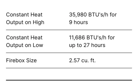

I was referring to max btu output of bk.

Yeah, that's misleading. I'm sure BK has some real basis for those numbers, but they don't reflect what many of us have already tested and seen.
I can put 700k BTU of oak into my firebox and burn it down to dust in less than 5 hours. That's an average 140k BTU/h, and more realistically much higher than that in the first few hours, tapering to some lower number late in the burn. Yet BK lists max at 36k BTU/h... maybe on Balsa wood?
@Poindexter recently chimed in and said he can burn down his firebox in 4 hours, and does this every afternoon in winter. I believe he's burning Doug Fir, so similar heat output to me, but for ~20% less time.
Another new member with a BK Boxer 24 said they're consuming full fireboxes in 4 hours, so again, similar heat output, all roughly 4x higher than that number listed by BK.
I do believe the max output at 9 hours would be close to 36k BTU, if you burn a very poor softwood and don't pack the box very tight, as it adds up to only 323 BTU total (half-full stove?). And for full disclosure, @stoveliker says his stove takes about 10 hours to burn down a load at max rate, although I do have some trouble believing it, based on my own experience with two Ashfords.
Maybe BK is just listing worst-case for the worst install parameters, but the numbers just don't add up. Why would anyone put only 323k BTU's into their nice big Ashford 30, and use that to measure max output? The stove is only half full!
In the end, it doesn't really matter to me what stove you choose, but it's good to have accurate information in making a decision. Also, while everyone wants to pick the "right" stove the first time, don't sweat it too terribly much. You're not marrying the thing, and swapping stoves on a good chimney setup is really not that big of a deal. I had five stoves this house inside of about 3 years, 2012 - 2015, between various repairs of older stoves and ultimately finding what worked best for me. All stoves were sold within a few hundred dollars of what I paid, and sold very quickly from Craigslist, so even that was no big deal.

Two things. I repeat that Ashful's numbers only support his point IF the efficiency (ratio of heat up the flue vs into the room) does not change with a high burn rate. And BKVP says that it does not (significantly) change, see the post linked above. This is a repeat, but it's an important one for a consistent reasoning.
Second, in all fairness, there are users (well, at least 1 that I know of) that say that his BK puts out less than other stoves he's had in the same home/chimney with (I presume) the same firebox size. That's bholler. And his conclusion is based on how often he has to reload to keep the same temperature in the home. Hard to argue with that (too).
I had planned to keep my stove cold and use the minisplit past night and today. But it was windy, I missed the fire, and I have more wood than I need this winter, so I lit up again yesterday late afternoon.
Pine, 14% (okay, and one thin red oak split because it would fit and I did not have such small pine pieces). It was 40 F last night, 32 F this morning. It's been keeping my home (from the basement) at 71 F for 14 hrs now. With the swoosh at between 4 and 4.30. I gather that is a "high" setting for many folks. Not max, but higher than they normally burn. And I still have 20% of the "volume" of wood left or so (hard to estimate, and impossible to know what fraction of the BTUs that were in the firebox is still in there...)
16 hrs on pine around freezing and windy running 3/4 of the thermostat setting is good for me...
A LOT depends on how many BTUs you need. I.e. the insulation and sealing of your home.
