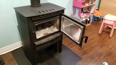

Hi, I'm looking to buy a 1 year old used Neo 2.5.

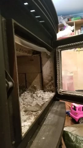

My only concern is the front top deflector - the thick steel one closest to the window that creates the downdraft: It has a bump in it as if it stressed with heat (or overheated) . The rest of the stove, including the stainless baffle, the door seal, weldings and all look just like new. This does not look like the stove got abused.
The seller states the stove is just too big for the room it sits in. I tend to agree with him.
Has anyone ever seen or experienced the same?
Thanks for your help!

Examine the baffle closely right behind that warped deflector area to see if there is a crack or something that would focus heat there. If no obvious sign, the baffle is straight, and not sagging badly on the bottom it could be ok. I am wondering if the deflector could be straightened out. If the stove price is good, then it may be worth it.
It's curious how, if the stove is too big, it would be repeatedly overfired enough to cause this? Is this stove on a tall flue system? Has the adhesive broken free on the door gasket at the top?
I'm curious how, if the stove is too big, it would be repeatedly overfired enough to cause this? Is this stove on a tall flue system? Has the adhesive broken free on the door gasket at the top?

You do bring up a good point: the stove is located in the basement of a 2 story house. My guess estimate is about 30 ft cheminey, althought I have not paid attention to it. The owner states his previous stove's baffle, a Neo 1.6 did react the same. He did talk to a P.Energy representative and he said it wasn't an issue, but it might not be the most reliable advisor in all situations.
I will pay a closer look to all weldings, seal and structual of the stove on my next visit - the seller told me he would make the stove pristine clean so that should make it easy to inspect those details.
