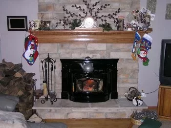

I really like mine :-) O'yeah, and its actually the brown enamel. Timberline I think they called it?
  • [Hearth.com] Looking to purchase an insert.....Hampton HI300 in Enamel Brown
