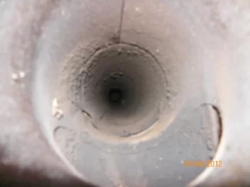

    I think it was Tony who asked to see what our chimney was like. My wife is the one who usually checks but today I took the cap off the tee and took a picture up the chimney. Here is what I found:
    By my feelings, it is time to clean. Sure, we could get by longer but not gain anything. So I think maybe tomorrow I'll run a brush up there. Notice there is not black creosote and we like that as that brown stuff is simple soot and a bit of fly ash.
    For those who don't know, the horizontal section comes out the rear of the stove into about a 2' run. That has a bit over 1/2" rise per foot of horizonal into the tee. Then it is up about 12'. Short? Yes, by all accounts it should now work but it does.
    We put the new chimney up in 2007 when we installed the Fireview. We did clean the chimney after the 2009 burning season (about a cup of soot) so what you see is 3 more burning seasons with no cleaning.

    Thats great, You can tell by the pic not a trace of creosote. What stack temp do ya average with that Fire View cat? I know your wood is A-1 seasoned !

    I think someone neglected to teach your stove about the principles of thermodynamics. No stove run as often as yours should have a chimney that looks like that especially with only a 12 foot rise! Absolutely amazing - it HAS to be that Dennis wood! but only a 12 foot rise??? Totally amazing!

    Earlier today I looked and with stove top at 550 the flue was 320. That's about where it will run in winter months. We do get the flue a bit higher on reloads before engaging the cat and turning the draft down but the flue temp comes down quite fast.

    Thanks Tony and don't forget that pictures is after 3 full years of burning. For the benefit of those who are not aware, we heat 100% with the Fireview. Also, we had cleaned the chimney after 2 winters of burning only to get about a cup of soot from the cleaning. We do get some fly ash on the cat which we brush off with an old paint brush and also when we remove the cap on the tee a little bit of ash will fall down. But the really nice part is there is not black creosote! A testament to both the stove and the fuel.

    That's about what mine looked like after 2 seasons. My sweep said I should wait at least three years next time. Gotta love well seasoned wood and a clean burning stove.

    Yeah, yeah, yeah. My flue looks just like that........for the first couple fires after I clean it.:mad:

    Actually my chimney always looks like that for the first ten feet or so. The soot is always up higher.
