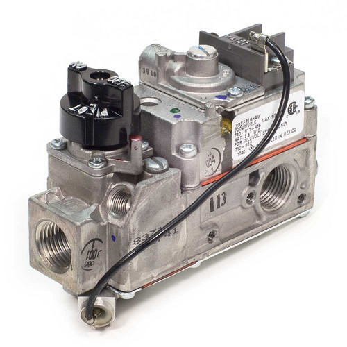

Ok. Replaced the entire pilot assembly and I'm still losing the pilot light. Confirmed good pressure on the gas line and it stays lit for sometimes >a day and the stove lights (when the pilot is lit) just fine. What else could it be? I just assume it was the old pilot assembly that was causing this...now I'm not sure.

The Thermocouple is what controls the pilot. Check to make sure that the pilot flame is engulfing the thermocouple properly.
Also, check the connection where the Thermocouple threads into the valve. Make sure that it is seated properly and has a good connection to the electrical element.
I'll post a picture but I guess the odd part is that it will stay lit for hours or even a couple a days at a shot. It's also odd that this is happening with the new assembly just like it did with the old which I'm thinking points to something other than the pilot assembly but I'm not sure.
It is a pretty short list of what can be causing it. If the pilot flame is steady on the correct area of the Thermocouple, the proper low voltage will be created, and sent through the copper end of the Thermocouple, to the valve where it will energize a magnet, which allows the gas to continue to flow through the valve, out of the pilot hood.
The problem could be the pilot magnet, which you can do an Ohms test on, or it could be something diminishing the pilot flame to the point where it is not heating the thermocouple sufficiently to maintain the pilot magnet. This could be low supply pressure of gas, or venting issues with down drafts moving the pilot flame off of the thermocouple.

Thanks for this info. I shouldn't have put the whole thing back together before confirming my fix. Pulling the metal cover and then the glass is a small pain. Kind of related question - could I leave the log set out while I'm debugging this or is it required to be in?
Control valve, problem with gas meter regulator sticking, venting issue (is the pilot dropping while the stove is on, thermo couple not adequately tightened,
