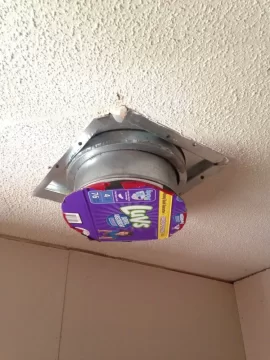

You do realize you will need to replace the chimney? Sorry if this has been covered already.
Unfortunately yes Webby. :confused: hopefully I will be able to construct a strong enough Wood frame within existing hole in the ceiling that will work for my 6" cathedral support box. I initially was going to try a liner but decided on buying new stainless triple wall. I didn't trust existing chimney
Getting the framing in there secure can be a little tricky on a modular. There's not much to screw to, and there is foam glue on everything. It can be done though.
