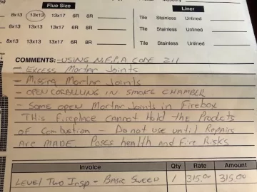

Ok. Level 2 chimney inspection done and failed. Luckily I'm not and never will be using it as a fireplace. All good to install the stove and liner. He did advise against installing the key damper. He says on a free standing stove yes but on an insert with a flexible liner he never does and never needed one. He said there is a chance for it to dirty things up. Not sure if I should install it since I have it or see how it runs first. Anyway, I have a bricklayer buddy coming over tonight to fix the mortar joints, missing mortar, and fill what can be reached in the smoke chamber. Whoever built this chimney 40 plus years ago- I hope they found a new profession shortly after they built this one. Chimney guy said unfortunately 40 years ago there were minimal codes for chimneys and the quality all depended on who the contractor was.

If the chimney doesn't have proper clearance from any combustible, then the liner must be insulated to be code compliant. With 22' of liner the stove could work fine without a damper. If it's more like 25+ ft, then it may need one. The installer might never have installed one, but the pros here have. It's not always easy, but when needed, it's better than having a hard to control stove.

Thanks! Yes I believe it has the proper clearance but I bought the 1/2" insulation kit so it's getting installed. Chimney guy said insulation is code around here anyway. The liner will prob be 22-23'. I have the damper so I'm putting it in just in case. I've read where these drolet 1800's breath easy and take off quick especially with a 20' plus liner. Getting this liner lined up is going to be tight. I may have to remove some bricks.
