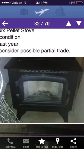

This is a st croix I found for 400.00. Anyone know what model and if that's a bargain.
Looks like a St. Croix Prescott EXL. I own one. Reliable stove. Versa Grate system can make a bit of noise however, if you keep it clean and lubricated the noise is minimized to a bit of rattle in the gear box. Can be remedied by packing it with more grease.
