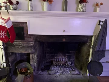

Rockport or Evergreen
New home to me = Historic home 200 years old probably 2,000 or less ft2. Primary heat is cast iron radiators fired by oil boiler. When that goes which is 40 years old and at end of life I will replace with gas most likely. Drafty and haven’t found them all. Vinyl replacement windows. Blowing cellulose in attic, spray is out of budget. Will likely spray foam rim joists however. Burn currently 8 gallons a day or $500 approx a month. During winter and it’s running almost non stop.
I understand cat vs not as well as soapstone style heat vs not.
This is going in the main cooking hearth of the home. Central chimney with 4 flue and I will of course have it professionally installed. I did it myself in my 30s all set.

Hmm…I guess I thought it would be side or front load. My hearth is 17” deep at the moment. If the stove sat out on the hearth I would then need to do something about the clearance with hardwood?
