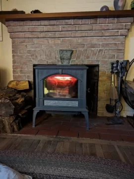

Good observation, and one I hadn't really thought about consciously, just kinda took for granted I guess.
Just now fired a fresh load of Mulberry and BL with one flat, wide slab of White Ash on top. There was a gap between the front bottom Mulberry round and the BL split slightly above and leaning against the back of the round, so I could see back into the bottom of the load a bit.. some flame back in there, fed by the ashpan housing hole, and some coaling establishing itself. Pic isn't great but you get the general idea.
Other times you can create a wall of flame coming off the front bottom split and covering the glass almost completely. Did I mention that I 💘 this stove? 🤗

Woody Stover, that’s the Woodstock Keystone? Nice stove with great viewing area! Love the design of the Woodstocks. Saw the fish design one. Maybe down the road if we move someday 😂 Also like how they are made in NH.
Reactions: Woody Stover
Woody Stover
Dec 25, 2010
13,121
Southern IN
Yep, that was another reason I sold the Fireview and kept the Keystone... for the fire view. 😏

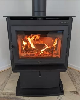

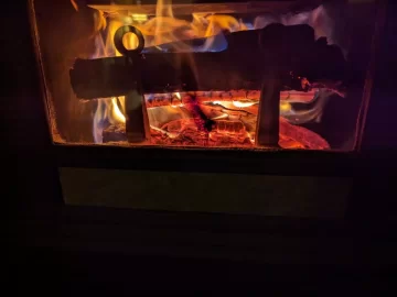

I have a Lopi Evergreen (Pedestal) and really like it.
Note I don't have much frame of reference as it's the only stove I've owned, but it drafts very well for me, can be closed down to a nice slow burn, and puts out a lot of heat. The big square glass gives a very nice view as well. The ash dump and large ash pan are also really convenient.
First burn:
