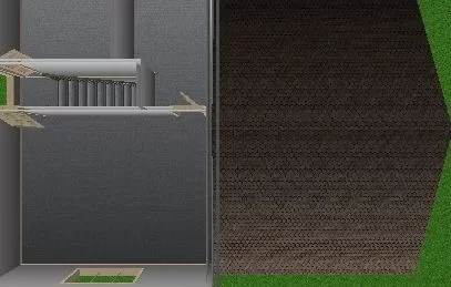

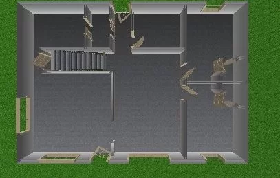

Im having a bit of trouble posting my floor plan so I will explain it as best i can for now. The house is a total of 1600 sq ft, 40'x28' The living room, which is where i would want the stove is centrally located on the first floor of the house. The second floor is 28'x20', so its a story and a half. The stairway is over 40" wide, with no turns expect to go right of left at the top to enter the master bed or spare room. I will keep trying to post a floor plan.
I'll second the Endeavor. Heats my 1200sqft 2-story 1910 house without trouble. Mine's 10 years old and nary a problem. I love the bypass.
I was thinking of the Liberty for the sole fact that it has a 3.1 cu ft firebox which would be nice for long burn times. But I wasnt sure if that stove would be too large for my home, meaning would I have a problem with it keeping it to hot inside the house, since you cant choke it down tight? Maybe that is a stupid question. Hope these floor plans help. On the right of the first story is two bedrooms, north center a bathroom, south center is the living room, left is the kitchen dinning room and upper left is mechanical room. I would like to put the stove, in the south east corner of the living room.

I've gone overnight easily on hardwoods, but our winters are milder than yours. You can load smaller fires in any stove. Maybe the Liberty would be a good fit. Probably depends on your insulation/windows/etc.
I have a 5 block high crawl space that is insulated. The rest of the house has R-19 in walls and R-38 in the ceilings which are all trussed not rafters, so no vaulted ceilings. The windows are all Andersons.
