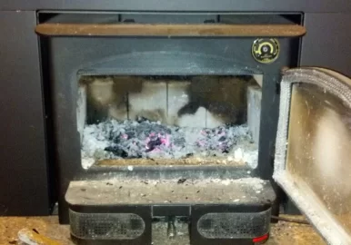

    For an insert that is rated to heat up to 1200sf and have a maximum burn time of 8 hours, I'm really happy with my 1250. I pretty much use it as the primary heat for my 1155sf house. It's extra impressive if you consider the fact that my insert is located in about the worst possible location for heating the house.
    I last loaded it today at 12:30 with 2 splits of Douglas Fir and 1 split of alder. When I left at 1:00 I had the air turned down low, the stove-front thermometer was at 450 degrees, and if I looked real hard I could see a tiny bit of smoke coming from the chimney. This is what I had when I got home at 11:00.
    I've been burning for 3 days straight and haven't had to use any paper to start a fire.

    Hi Blacktail,
    I have a Lopi Answer (same as 1250). I agree with the heat output and burn longevity for such a small stove. It heats my 1250 square foot house down to about 20 degrees F (it's a well-insulated house).
    Looking at the glass door on your 1250, I'd said your wood might be a little wet or you didn't have enough splits in there to maintain a high enough burn temperature for most efficient burning. If you try >3 splits, you might get a cleaner burn and cleaner glass after the burn. My Lopi usually cruises at 550 degrees F on top middle front of the stovetop.

    I noticed the glass in the picture. I've been burning since the first of October and haven't cleaned it once. But it is quite possible that some of my wood isn't perfect. And I may be guilty of turning the air down a touch more than necessary when I leave for an extended period, but I usually look at the chimney and try to make sure there is little or no visible smoke. I don't want to be "that neighbor."
    As the pic shows, my thermometer is on the upper front corner of the stove. I don't know how its readings compare to units placed on stovetops, but I've reached 575 degrees once and that was the one time I thought it was getting away from me. Where my thermometer is mounted, 400-500 seems to be good and hot but still under control.

    575 is no where near the getting away from me temperature. When it starts to get close to 800 and shows no signs of stopping then you better start to get worried.!!!

    Absolutely. I routinely run my Freedom up in the 650-750 range. Overfire is north of 800.

    Hi Blacktail, I can see why you would have the thermostat there - tough to fit it anywhere else when the 1250 is an insert and not freestanding. In any case, I've been guilty at times of trying to turn the air down too quickly on my Answer and when I do, it doesn't get hot enough and I get more residue on the glass. I've found that if I let it get to 500 degrees stove top before I begin to restrict the primary air in four steps about 5 minutes apart, the stove may hit 600 or 650, but it quickly settles in at 500 to 550 F and cruises for a long time cleaner burning than it otherwise would have been with no "smoky charred" logs at the back of the stove at the end of the burn.
