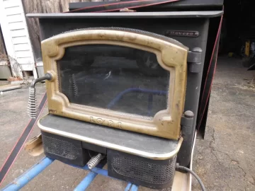

Your lucky day! Listed right next door to you listed 12 days ago.
lopi revere fire place insert with surround - $900 (brookfield,ma)​
I have for sale a lopi revere wood stove fire place insert with UL tag. this stove has hardly been used. all fire brick are good. has a surround to cover the gaps around the stove. good gasket and blower $900 as is or I can sand and paint for $1200.
