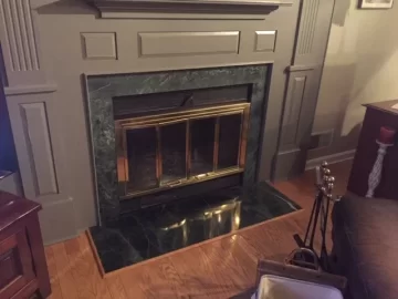

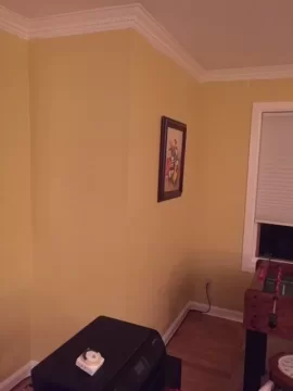

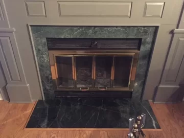

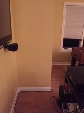

I truly appreciate the great advice. When I was in my local wood stove store today their installer happened to be there. He said they often pull out the old fireplace and install the new one from behind - saving my woodwork surround. He has not yet been to my house for inspection. My setup is on an interior wall. Seems to make sense but in your opinion does this work. (Please see pictures of back wall) Also, I am concerned with power outages which we often have where I live. I like the Lopi because it extends and seems like it would be more efficient in that scenario. Would the Kozy Flush Mount produce the same amount of heat without the fan blowing? Thanks for your help!

The Lopi Revere is an insert, not a fireplace. It goes into an existing fireplace. The Z42 is an actual EPA fireplace. The model of the Majestic is important if you want to consider having a Revere insert installed into the current fireplace. Some models strictly forbid installation of an insert into them. Often the model information is on a small plate usually on the doorframe. Can you locate that?
The Kozy Z42 will convect naturally without the blower running. The heat output will not be as strong, but it will heat. If power outage heating is a major concern then is installing a freestanding stove in another location an option?
