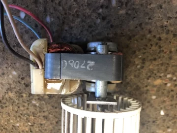

I have a 86 Lopi savoy inset fireplace. The one blower motor coils burned up. Trying to find a replacement motor without spending the 300 on a whole new assembly. It’s a uppco motor. 3 speed. 3/4” stack and a 3” shaft. I’m having zero luck. And I can’t make out the number on the side. Any help for a aftermarket replacement?

Finding a generic three-speed replacement makes it a bit challenging. It might be easier to replace with a single-speed motor and add an inexpensive fan speed control. This style motor is common for bathroom fans. Make sure the rotation and shaft diameter are correct.
Amazon product ASIN B078XQ27G3
Should have been metal. Sounds like you are going to have to improvise. Look at bathroom fan parts. Example:
Amazon product ASIN B07DFNHVHR
Or maybe try to figure a way to adapt a different blower system?
